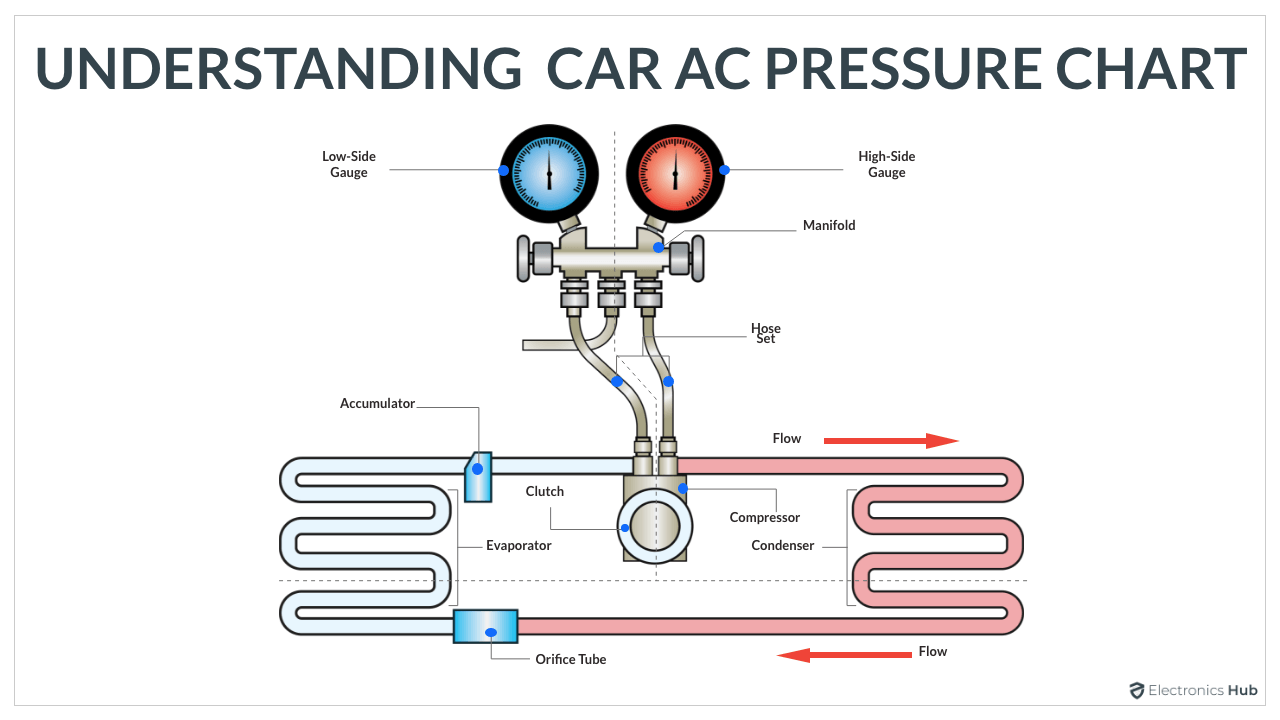

There's a lot of "My A/C isn't working in Texas" threads - mine's a little different. I recently replaced the compressor and drier in my system as my high side only ever reached 150 psi, and the low side needed to be slightly overcharged to 70psi just to get a modicum of cold air on days below 90 degrees. I got tired of playing the odds and replaced everything. I even did a little video on it you can see here, with an alternative freon solution :
Anyway, fast forward to today and I began noticing a couple things - if I leave the controls to 60 degrees, it'll freeze my face off. If I touch the controls to 65 degrees or higher, it instantly turns stale. If I clear 80 degrees, warmer air comes from the left vent and the driver's side center vent, but cooler on the passenger center and right vent. I began thinking maybe it was the dual zone valve, but not really sure how to diagnose. If this happens, the rest of the trip remains stale with the controls back down to 60 no matter what I do. Every once in a while I can raise it to 90, feel intense heat for a minute or two, then drop it back down to 60 and it starts freezing my face again... this doesn't always work.
What does work? When I key off from my commute, leave the car for a few hours and start it up for another commute. Then it's face-freeze again which is nice, but then I'm stuck modulating the temperature by simply turning down the blower. I dare not tempt the gods living under the hood to torture me with stale air again.
Not really sure where to attack this - there are no leaks, pressures are reading 35 low, north of 170 high at idle. I only put in 24 out of the total 28 ounces this go-round, but I do have the means to top-off if need be - though I doubt it's a refrigerant capacity issue. On a side note, my car celebrated it's 20th birthday since new model year production was late summer 2002, and she just cleared 70k miles. It's been a great car for the past 4 years I've owned it, but aside from this a/c gremlin, I'm still trying to nail down a coolant leak that's about as schizophrenic as the a/c is. That's a different subject for another day.
You probably have a clogged condenser,also the stale smell is most likely the cabin air filter.
It's not a smell, it's a temperature - if I leave it at 60 it's fine, but if I want to run it at say, 70, the air is substantially warmer. It's almost as if my system has 3 settings : ice cubes, locker room, sauna. There's not much of an in-between, but it definitely feels like an electrical issue where it's bleeding heater-core air without proper modulation.
Your high-pressure circuit is too low at 205 PSI if the ambient is 100 degrees.
The high side circuit at 175 to 210 PSI is ambient at 80 degrees.
